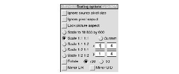

Scale 1:1 1:1 gives a full-sized image (the same dimensions as the original). The other Scale options set different preset scaling ratios.
Custom gives you finer control over the size of the output image. You can either set your own scaling ratio by filling in all four boxes, or you can set the size in pixels by filling in the left x and y boxes only, leaving the right boxes blank.
Scale to fill scales the image so that it covers the entire screen area at the current display resolution; this may distort the aspect ratio.
Ignore source pixel size ignores any source information about the pixel size. This can be useful if you have images that use a non-standard pixel size. The pixels are all considered to be square.
Ignore pixel aspect ignores all the size information in the source file. Both source and output pixels are considered to be square.
Lock picture aspect prevents the Scale to fill and Custom options from stretching the image horizontally or vertically. The output image will fit within the size you specified; it may be smaller than you asked in one direction only, to avoid changing its aspect ratio.
Rotate can shift an image through 90° (+90 is anticlockwise).
Mirror performs left/right and up/down mirror operations on an image.
If you select Rotate and Mirror, the rotation is performed first.

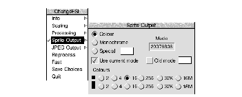

Colour gives an image in colour.
Monochrome gives an image in shades of grey.
Special allows the use of special file suffixes. These are the same as the <mode> parameter described in the on-line documentation file CmdBasUse .
Use current mode outputs the image for display in the current desktop Display manager mode.
Old mode allows you to output the image for display in an old-type screen mode:
Enter a backward-compatible screen mode number. We don't recommend that you use this method (it is overridden if you set a colour mode and then use the Monochrome button).
The Mode number is only useful in old-type screen modes. It's an information box (you can't enter anything into it). When Use current mode is selected, the mode number generated with new style screen displays has no significance.
Colours : The two rows of 2, 4, 16, 256, 32K and 16M buttons set the number of colours in the output image. The top row beside the square box chooses a square pixel mode, and the lower row beside the oblong box chooses a non-square (90 x 45dpi) screen mode. For monochrome output the 2, 4, 16 and 256 buttons set 2, 4, 8 and 16 greys respectively, and you cannot use the 32K and 16M buttons.
Monochrome produces a monochrome image.
